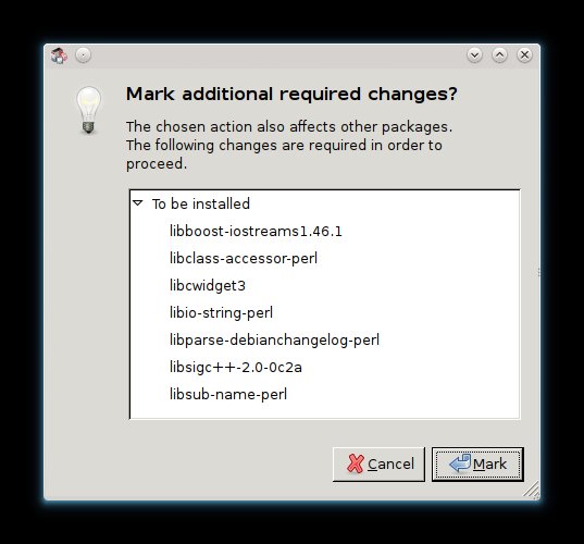

          I also use apt-get to quickly update and dist-upgrade, but for package management I use Synaptic. When I tested Synaptic to see what is did to install aptitude, I get the packages listed in the graphic. I checked my system and found that the package libgpod4-nogtk was installed. I have not used muon very much, but initial experiences with it made me suspect that it would not always show all the packages that would be installed and removed. I got the impression that it was a "dumbed down" package management system.

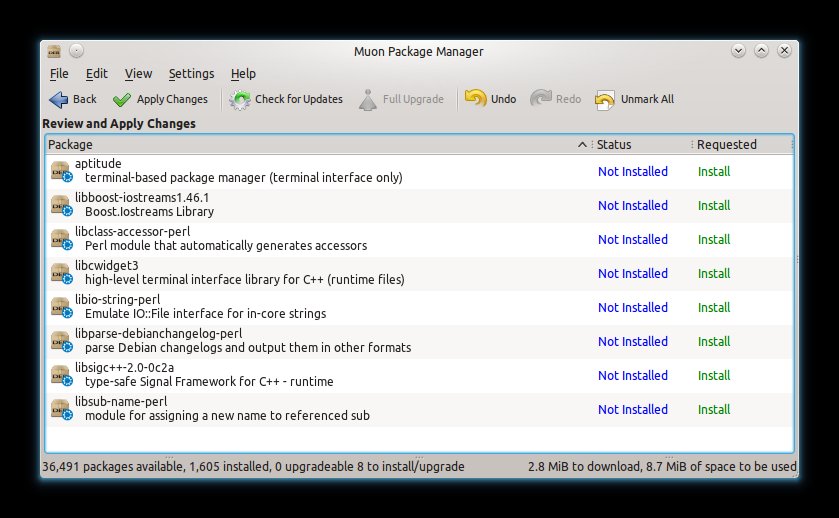

            One thing that bit me early on when I first discovered Muon and used it to prune packages from my PC was the Preview Changes button:
            Once de_koraco called it to my attention, I regularly check this before let Muon do any work.
            Here's what that button shows when I instruct Muon to install Aptitude:
            Your screenshot shows the package libparse-debianchangelog-perl because Synaptic, like Muon, defaults to treating recommended packages as dependencies. I've explicitly instructed Muon not to do this by unselecting all options:

            I'm at a loss to understand why your Synaptic wants to install libclass-accessor-perl, libio-string-perl, and libsub-name-perl. Those aren't installed on my PC now, and you can see that neither apt-get nor Muon want to add them on mine...
              Re: aptitude vs. muon
              Thanks for the insights regarding muon. I will have to start using it now as I like the interface. Regarding the packages that my system wants to install we seem to have differences which I am at a loss to understand. When I changed muon to the settings you are using, I got the same packages as with synaptic
