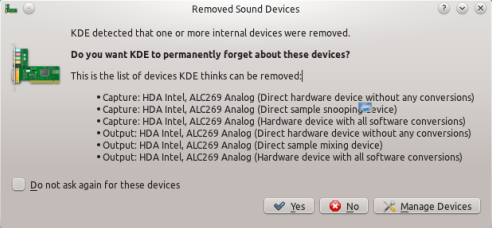

              weired thing is that... recently a dialog box was poped up indicating that it has found few devices that are not needed at all (!) do I want to premanently remove them? (whats that?!) which since I was not sure, I just closed the dialog box. (I didnt choose neither yes or no)

              and weirdly, only the intel one was working, not ATI. the dialog box that poped up also was asking to permanently remove the ATI. (should I have clicked yes?)

                    this is the dialog box i receive (snapshot)
                    and, somehow my sound suddenly goes dead, and when I restart back its fine, againg dead, restart, dead, restart... >
                    I feel that whenever I receive that dialog box message the sound dies.
                    so far I havent decide to click yes or no yet. just closed it. which one I should choose??

                        and again, even for this one again I got the message that I posted a snapshot in last 2 posts...
