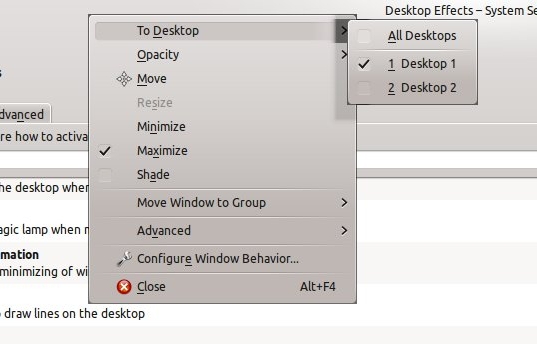

    Shadows that are part of the Oxygen window decoration (i.e. the default glowing blue shadows around windows) show up just fine but regular shadows that are supposed to appear under menus and such don't appear. I've noticed that there's a thin bad looking outline that looks like the beginning of the shadow but the rest won't appear unless whatever's underneath the shadow updates. Look at the screenshots to see what I mean. For the screenshot I had the the Shadow settings (under Desktop Effects) set very large and dark so that you can see the error more clearly.

      It is a problem. As you can see, the only place the shadow showed up correctly is next to the second menu. The rest is just a thin dark line. I know what the shadow's supposed to look like.

              Why have a new shadow system? It's shadows, and they work, there's nothing they can do except in this case, break them. If you look closely there's about a pixel of a shadow around the edges of the menu and there's a sharp corner from the shadow.

                            It still doesn't make sense that the default oxygen theme wouldn't have working shadows. The window shadows work just fine but only because they are built directly into the theme. I'll post more pictures later.
                              Re: Shadows don't appear
                              Ahh, I see what you mean. Menu shadows do appear for me when using "proper" oxygen (though so subtle you can barely tell).
                              However, gtk apps using the oxygen theme (oxygen-gtk) weren't showing shadows in menus after the updates.
                              I had to manually install a newer oxygen-gtk version to get those.
