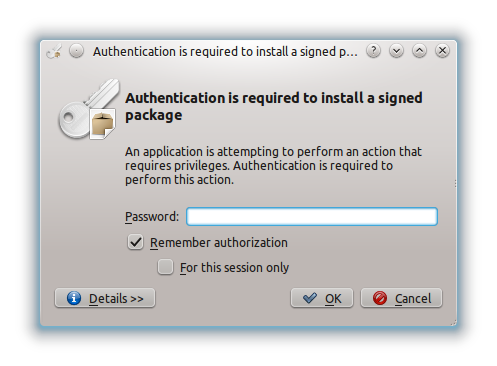

              Thanks for the replies everyone. As a follow up, I've attached a screenshot here of the dialog. The password is the same password for logon, however, I'm prompted to re-enter for installation of a program.
              As an FYI, entering the wrong password does *not* prompt you for the correct one. As I mention in the original post, it simply saves the wrong password and fails authentication every time without a prompt. Seems like that may be a bug? The 'remember' box is always ticked by default. How can I turn that off?

                That dialog is asking for your account password, since yours is the first account created during the install its password is what is always asked for by system dialogs such as the one you've attached, or if you use kdesudo or sudo in a Konsole. However, I'd never check the "Remember this password", only the "This session" option.
                If the wrong password is entered the installation should fail because only "root" has access to the system directories and files. Then, you'd rerun the app and enter the right password.

                  Like I mentioned, this is not a kdesudo (sudo) issue, so resetting kdesudo timeout won't help.
                  The dialog you took the screenshot of is the policykit dialog (the "remember authorization" and "for this session only" are the giveaways, kdesudo doesn't have them)...and policykit is separate from kdesudo.
