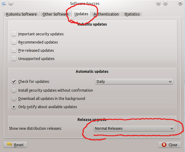

      You lucky folks have Natty to try. I can't get it to download! The very first step, according to https://help.ubuntu.com/community/NattyUpgrades/Kubuntu, is to click on the upgrade notification. Well, I'm running 10.10 64-bit Kubuntu, and I don't get an upgrade notification. Not only that, but neither Synaptic nor KPackageKit seem to know anything about it. I guess it really is released now, but I don't know why I see no sign of it.
      you need to check the sources. from kpackagekit click on settings>edit origins>update tab and check that "show distribution release" is set to "normal releases". this seems to default to long term releases only and that will keep you from seeing your upgrade option.
        I've had the distribution releases set to "normal" all along. That's not the problem. The effect of all my efforts to fix the problem, however, is that after reinstalling kpackagekit, it segfaults on startup.
