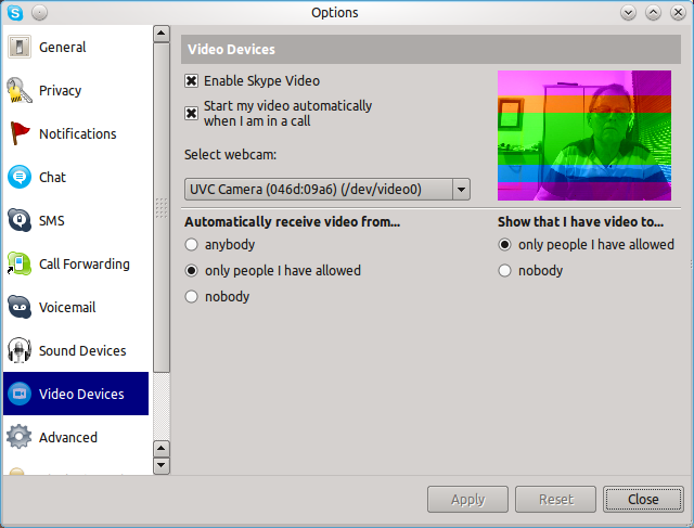

    I have noticed that others have reported problems after updates. Well today, after the updates, the image from both my web cam and my laptop web cam had similar distortion when I used the Video Options of Skype. I reinstalled most of the updates as well as Skype and the distortion was unchanged. The image below shows the distortion. I found that if I choose configure in Kopete, the web cam image is not distorted.
    I would like to know if anyone else has had a similar experience with Skype after the updates or if there is something that can be done to fix this type of problem.
    I wish to add that this problem only exists on my 64B ASUS F3Jr Laptop. On my 32B desktop, which is several years old, this problem does not occur. Unfortunately Skype on this desktop does not give 640x480 images as on my Laptop.

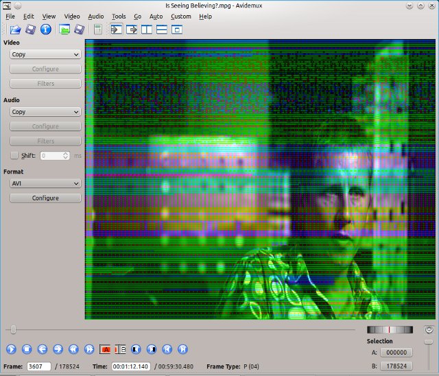

    Well Skype is not the only application that gives video problems. I have now found that Avidemux which I use for editing mpg files gives the same visual output when playing a movie. When single stepping, the image is not corrupted. For Avidemux, the >Tools>Preferences>Video shows "XVideo (best)". I used Synaptic to list applications with xvideo and did a reinstall which did not change the display of Avidemux.
    I am not very familiar with this aspect of Kubuntu, but to me it seems that the problem that I am experiencing is related to the XVideo rather than the web cam. Is this a possibility?

      Now Skype video is working as before but Avidemux has the same corruption as Skype did when Avidemux plays a movie. I now have to resort to using KpackageKit for selectively installing updates instead of using:

      No doubt I will keep checking for updates that are likely to fix the problem. The first indication for me will be when Avidemux video works correctly and doesn't look like what I am getting as shown below.
