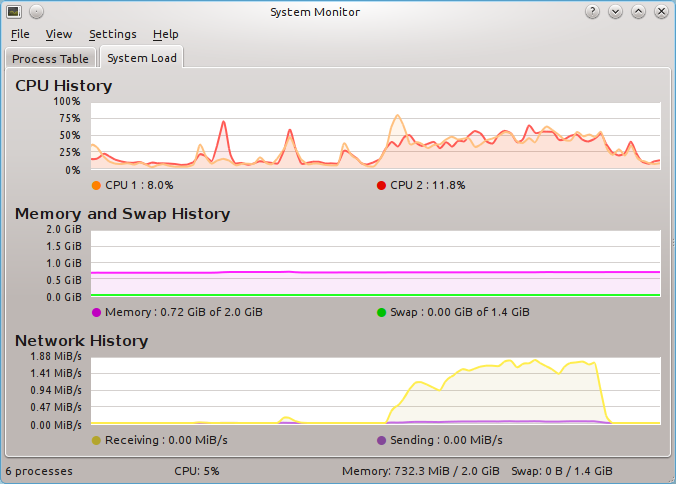

                            I do indeed have the wireless card you suggest. I do not know if (rev 02) is any better.
                            03:00.0 Network controller: Intel Corporation PRO/Wireless 3945ABG [Golan] Network Connection (rev 02)
                                Subsystem: Intel Corporation PRO/Wireless 3945ABG Network Connection
                            I downloaded an mpg audio file and the system monitor plot is shown below. As you can see, the peak rate was about 1.8MiB/s which is 14.4 Mbps. I also did a speed test between Milton Keynes, UK and Sydney, Australia using http://www.speedtest.net/index.php. The download was about 6Mbps and the upload was 0.9Mbps. These speeds are considerably faster than what you are saying. I am quite happy with these speeds as they are well above those required for skype.
                            All the people that I communicate with use Windows, so a non-skype option is not that useful. As you probably realize, the video can be stopped in skype to use voice only. I always like to see the person who is talking, so I provide my picture as well - particularly when dealing with family.
