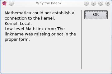

    I had kubuntu 9.10, and I installed mathematica 7 on it. Then after the
    next kubuntu came, I upgraded my system to kubuntu 10.04. Now I can't use
    my mathematica.
    I get the error:
    " Mathematica could not establish a connection to the kernel.
    Kernel: local.
    Low-level Mathlink error: The linkname was missing or not in the proper
    form. "
    I've removed and re-installed math, but he same error. Also I tried math6,
    but it didn't help me.
    I don't know how to solve this. I'm also not too much expertise neither on
    kubuntu nor on mathematica. But I need to work with my math!
    can anyone please help me?
    Thanks in advance,
    Lol
    p.s: the error window is attached.

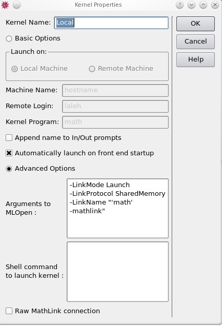

      Thanks for the answer. The problem is that I do not understand what these pages tell me! I've read them before, and tried the things that came to my mind, but . and also these guides are for starting remote kernel, while I want to manage a local kernel!
      There is a window in mathematica in which one can change kernel properties, I've attached mine. Maybe it can help.
      Please, if you've any other suggestions I'd be grateful.
