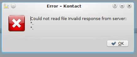

            Here's a screenshot from another bugs.kde bug report, showing the same behavior (and this person is not possibly using either my ISP or my hosting provider email server):
            [img width=400 height=232]http://bugsfiles.kde.org/attachment.cgi?id=42903[/img]
            That bugreport is for Arch. Here's someone using OpenSuSE having the same issue.
            This is definitely a KMail issue, not a mail server issue.

                  I can report a similar issue. I am using three freemail accounts with kmail and since either the last KDE launchpad update in Karmic or the update to Lucid (it definitely started after an update), Mail sometimes is fetched more than once. I have always (since 8.04) had Kmail set to leave the messages on the server.
                  The mails it fetches again seem to be random, some are 2+ years old, others are more recent. Sometimes (like once or twice so far), when it happens, this is preceded by an error message from Kmail saying something about a failed command (quoted as "" or similar). Also sometimes (a bit more often), I get errors about the server not supporting whatever Kmail needs to determine which mails have already been fetched (Kmail should have that info in its own database files anyway...).
                  Kmail is set to poll the servers once every 15 minutes, my machine runs like 10h/day, and the problem occurs about every 2-3 days. My setup is the same as the OP's. Since Akonadi has quieted down a bit, this has become the most annoying bug in Kmail/Kontact
                  Edit: Just got the error message again.
                  Edit2: The other error message I mentioned. This morning, Kontact fetched 20+ old emails from one of my accounts. Starts to get really annoying
