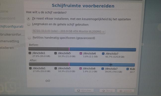

          Thanks, i followed all the steps, installed kubuntu but ended up with the same result. When i choose kubuntu at startup it just reboots.
          Made a screen of the hd installation step. As you can see at "before" i have 4 partitions. 1 and 2 for windows (gray), 3th is swap (pink), 4th is linux in blue (used ext3 cause ext4 wasnt an option in Partition Magic, i also read that the differences between them arent that huge).
          I assume that kubuntu recognized the linux filesystem and wanted to install it there. This you can see at the "after"-bar. The black arrow on the right was automatically on the right partition.
          and in the final step let it install Grub to the MBR of the hard drive.
          So 'let it install' means kubuntu automatically installs this? I did saw that at the end of the installation there was a "pass" option for certain parts, like language packs, but i didnt pass anything.
          What am i doing wrong
