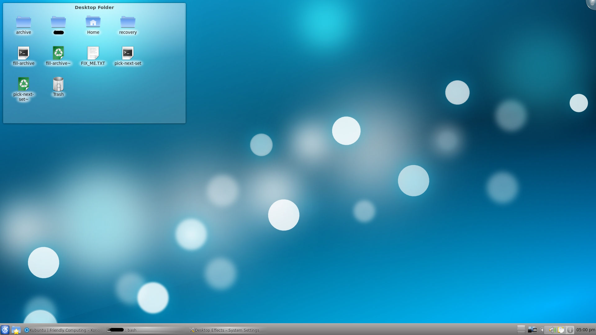

      Hey Snowhog, thanks for replying. I really don't believe the desktop theme is the problem here. I'm actually not getting any transparency on the desktop. For example the wallpaper is not visible through the taskbar.

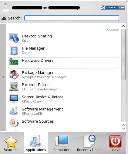

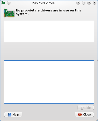

                    If you check System > Additional drivers does it show an nVidia driver available for use?
                    Slava Ukraini! πŸ‡ΊπŸ‡¦
                      Re: Taskbar no longer transparent after upgrade to Lucid. Compositing disabled?
                      That doesn't seem to exist on my system. I found something called Hardware Drivers. I launched it. It searched for a short time and reported no proprietary drivers.

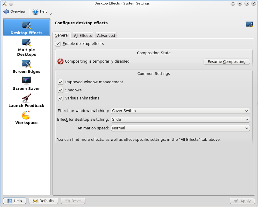

                        I tried clicking resume compositing and then apply, but nothing happened. There was no indication that I had clicked anything at all.
                        I created a new user account and logged in with it. No transparency was evident on the desktop so I went into system settings -> desktop effects. The box for enable desktop effects was unchecked (clear). I checkmarked it and clicked the compositing button. An error message appeared and told me to check my X configuration. It was not at all clear from the message what I'm supposed to be checking, especially because I don't even have an xorg.conf file.
                        I also investigated the documentation for the desktop effects applet in help. Pretty sparse, not much info there.
                        Snowhog, you mentioned the theme, but I can't even find where to change that. It seems like every part of KDE4 has its own theme settings now, but there isn't a unified tool where I can just set the theme for the whole desktop at once.
                        So what am I missing here?

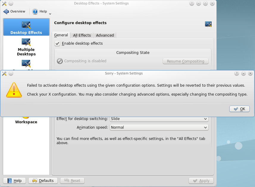

                          Here's the error message I get when I try to enable compositing desktop effects on the new user account.
