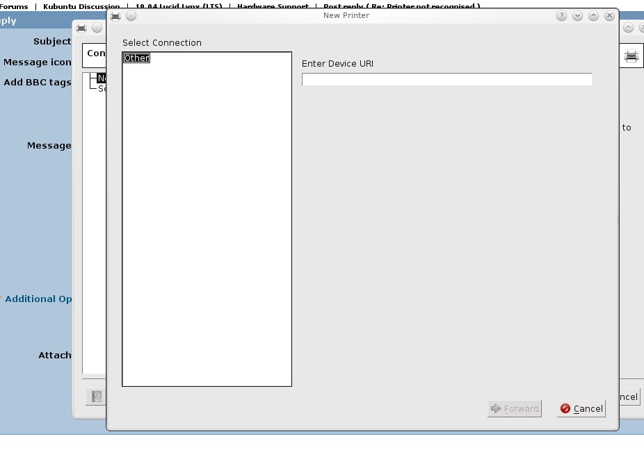

                  How did you actually fix it? Did you do the parallel:/dev/usb/lp0 thing? I can't see where/how to do that though...

                    Yes. You need to follow the link to the Bug report, where "Begining with comment #24 by Till Kamppeter, resulted in the solution, all today!"
                      I did, and I can't find a solution.
                      https://bugs.launchpad.net/ubuntu/+s...ps/+bug/468701
                      Are you talking about this:
                      Paul L, I see, HAL and its CUPS backend were working around the problem that your printer does not return a usable device ID. HAL is deprecated now and therefore the hal CUPS backend is no part of Ubuntu any more. If your Panasonic is your only USB printer you can use the device URI
                      as alternative in Karmic or Lucid.
                      K->System->Settings->Printer Configuration ... then I can't see any way to get that in there

                        Re: Printer not recognised (more problems)
                        In K->System->Settings->Printer Configuration ... click on Network Printer.
